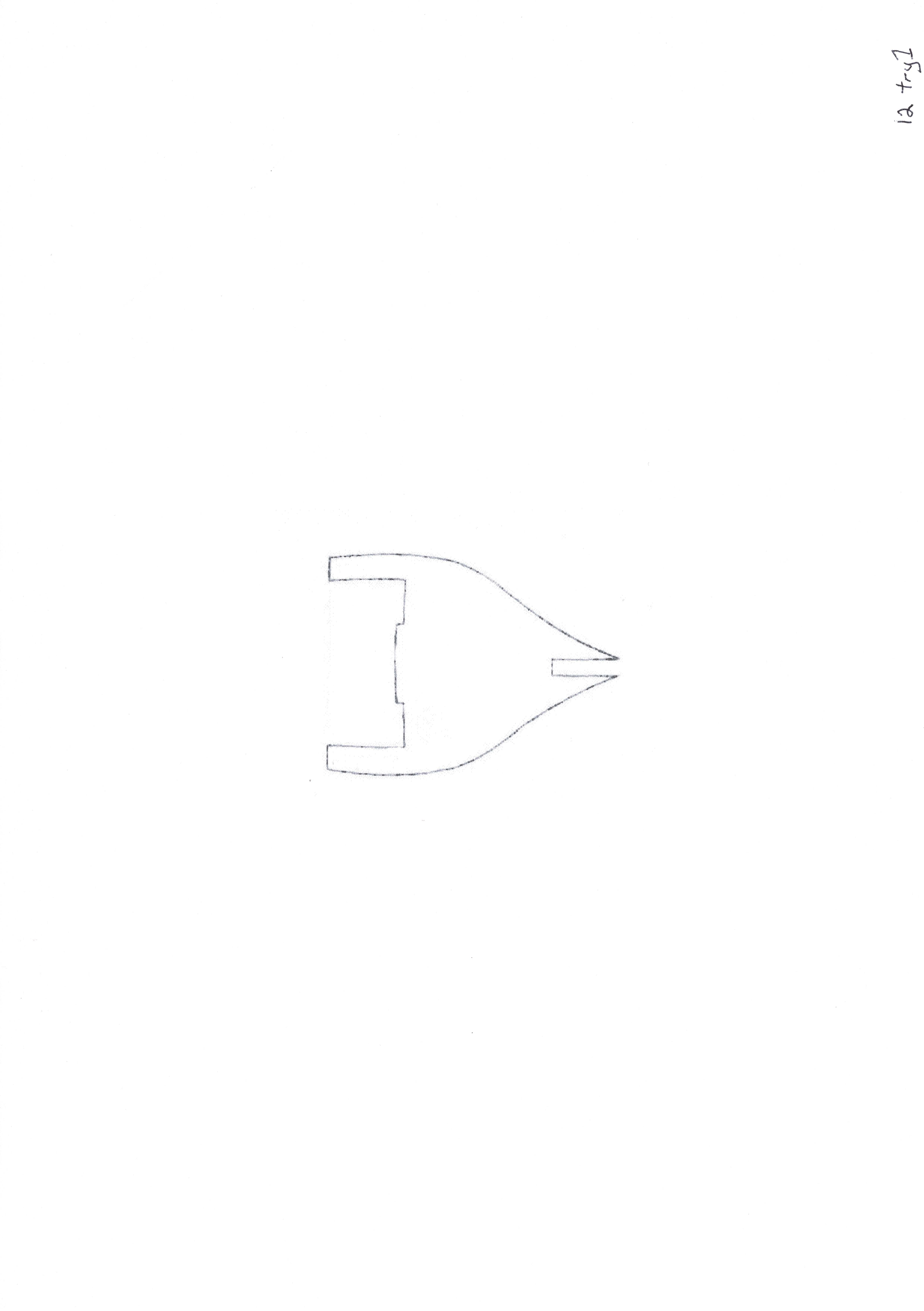

I have an Image on an A4 sheet that I imported into QCad. The sheet shows as nearly 4500 x 6500 whatever the sizes are on the screen but not the 210mm x 297mm I was expecting. How can I sort this out ? Please.

Post by CVH » Fri Jun 13, 2025 12:02 am
Hi,
Your image is probably a bitmap ...
Assuming your drawing unit is 'mm'.
It would have been handy if at least the picture file was attached, see How to.
Also see above Forum Rules in red.
Bitmaps don't store their actual size apart from NxM pixels.
The size of the visual representation depends on the DPI (screen/paper/...).
On importing QCAD treats 1 pixel as 1 drawing unit by 1 drawing unit.
Suspecting that the bitmap is '4500 x 6500 or whatever' in pixels.
The aspect ratio of ISO A paper is sqrt(2) or 1.41421356..., 6500 divided by 4500 is 1.444... (not really a match)
On inserting a Bitmap QCAD displays the Width and the Height on the Options Toolbar.
- Initially the width and height in pixels.
- Ensure that the 'Keep Proportions' button is active (connected chain icon).
- Alter Width to 210, Height should adapt to about 297 OR alter Height to 297, Width should adapt to about 210.
If that is not the case then the aspect ratio of the Bitmap does not match with that of an ISO A page.
With 'Keep Proportions' inactive you can adapt both values but remind that you are scaling the Bitmap not uniform in X and Y.
This may change the original aspect ratio of your Bitmap in QCAD.
Technical detail: Screen dots are not per definition squares, printer dots can be. :wink:
One by one drawing units in vector art is exact.
Afterwards, if the Bitmap is already inserted as entity.
- Select it.
- Start the Scale (SC) tool.
- QCAD requires a focus point, as per screen capture for example the left lower corner = drawing origin.
- In the Dialog: opt for 'Delete Original', 'Proportional' active and set an appropriate scale factor. e.g. '210/4500' or 0.4666...
Input fields for values support simple to complex equations without the '=' symbol.
- Acknowledge the dialog.
The Bitmap entity in the drawing is now scaled with a fixed aspect ratio.
Not proportional you can enter 2 scale factors.
Quick and dirty:
- Select the Bitmap.
In the Property Editor:
- Set 'Width Factor' to '210/4500' (=0.4666...) here '4500' is the current Width.
- Set 'Height Factor' to '297/6500' (=0.0456923...) here '6500' is the current Height.
Scaling the Bitmap not uniform with the given numbers.
But then you're comparing sour apples with potatoes, taking pixels for drawing units :wink:.
To convert geometry in a Bitmap to vectors you have at best 2 known dimensions in orthogonal directions.
Then it is possible to scale the Bitmap almost correctly in X and in Y.
Tracing the outline as vector line art afterwards.
Another route is tracing the Bitmap as it is, scaling the vector art afterwards.
Bitmaps may also be rotated slightly.
Then 'Align Reference Points' (AE) with 'Scale' active can be handy.
Aligning 2 known, almost diagonally opposite points, in the Bitmap with 2 target positions in the drawing.

Sorry about missing out the image. I have attached it now. Just to explain a bit, I have a lot of A3 sheets that I can manipulate on my Brother Printer/Scanner. I open these sheets using Gimp and use Rectangle Select to select the single frame I want, I then Crop to Selection and save as a .jpg this jpg is then saved on an A4 sheet and this is the sheet I use to Import into QCad . I may have to find a different way to prepare these images for Laser Cutting.

The size of this image is 4912 x 9670 in pixels.
The aspect ratio is even worse compared with the expected sqrt(2).
I understand that the A3 sheets have various shapes on them.
You then scan that with an A4 scanner, top half & bottom half.
What is the resolution or DPI of the scanner?
I would use the scanned input directly and trace each shape of that.
The larger and more detailed (e.g. 600dpi) an image is to trace ...
... The better the trace will be in vectors.
Vector art can be scaled to any size without loosing data or accuracy (almost).
The information will not get any better beyond this point.
Data in a JPG file is not lossless compressed.
You loose original information on each decompression, cropping and re-compression.
You also know that the scanned data is an A4 page and can work out the Bitmap scale factors.
Those are expected to fit the paper aspect ratio better.
You can even combine scanning with some ruler marks on or under the A3 content.
Then you can scale the scanned A4 data with some degree of certainty.
A bit as CSI documenting a crime scene with photos using an L shape ruler so that the size is well known.
You state 'this jpg is then saved on an A4 sheet' but that comes after it is cropped and saved as a JPG.
What you probably mean is:
- Crop a certain rectangular area of the scanned page.
- In Gimp set the cavans size to 210 by 297 in mm (209.90x297.04 at 72ppi).
- Center cropped area.
- Save as JPG file.
Otherwise explain the steps to save it on an A4 sheet.
Why not use the JPG with only the cropped area?
... Most of the A4 canvas is empty.
