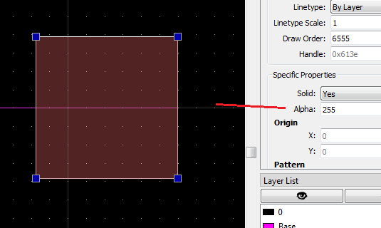

Change the Alpha value of the Hatch entity in the Property Editor.

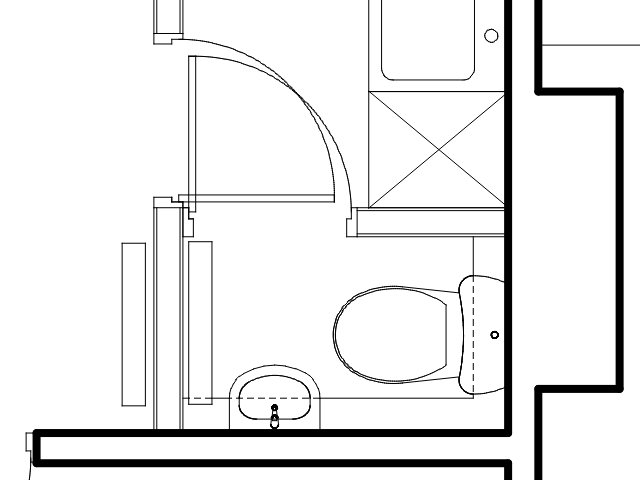

just for clarification. A proper CAD drawing would contain the hidden parts as a dashed line like this example:
What you are trying to do is to use features from a Graphical software in a CAD software - that will only work to a certain point. I don't think it will ever work with the chosen color black or white just because the Model_Space has a black background and the Print Preview has a white background. What ever the QCAD preferences are to deal with black on black or white on white has to fail in one or another way. That's fact!

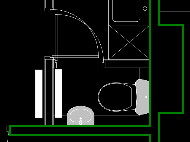

Howsoever - to come close to your goal you could use colors for the hatch like "Light gray" or something similar and the result could be something like this:
in Model_Space ...
... and in Print Priview
If the hatch is still hiding lines you can play with "Bring to Front" or "Send to Back". BTW: I kept Alpha to 255 ...
in Model_Space ...
