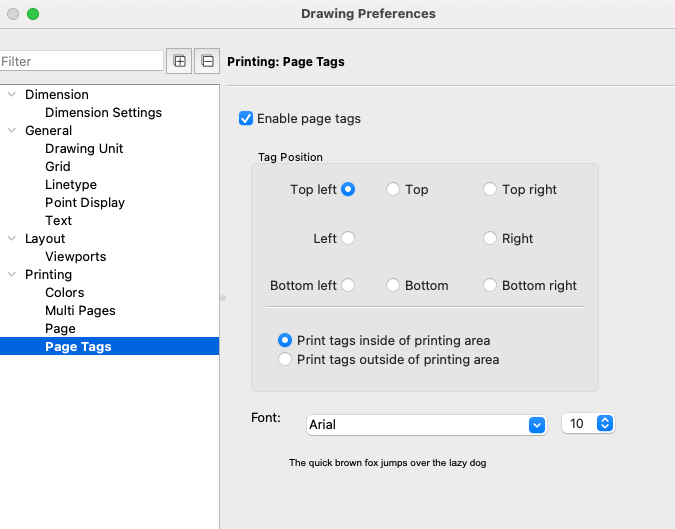

				What are page tags and what  are they used for
				Posted: Wed Jul 02, 2025 9:28 am
				by Nenagh52
- Screenshot 2025-07-02 at 09.25.09.png (53.69 KiB) Viewed 19326 times
thanks as always

				Hi,
The number of pages can be set to a number of rows and columns.
With paper tags QCAD includes a text in the nature of A1 or B3, ... at the selected position.
A-B or the column, 1-3 or the row.
Probably absurd ... After column 'Z' comes column '['.
Useful to know which page belongs where in a collage of pages.
They may not print if set outside the printing area and if that is the actual printer limitation.
