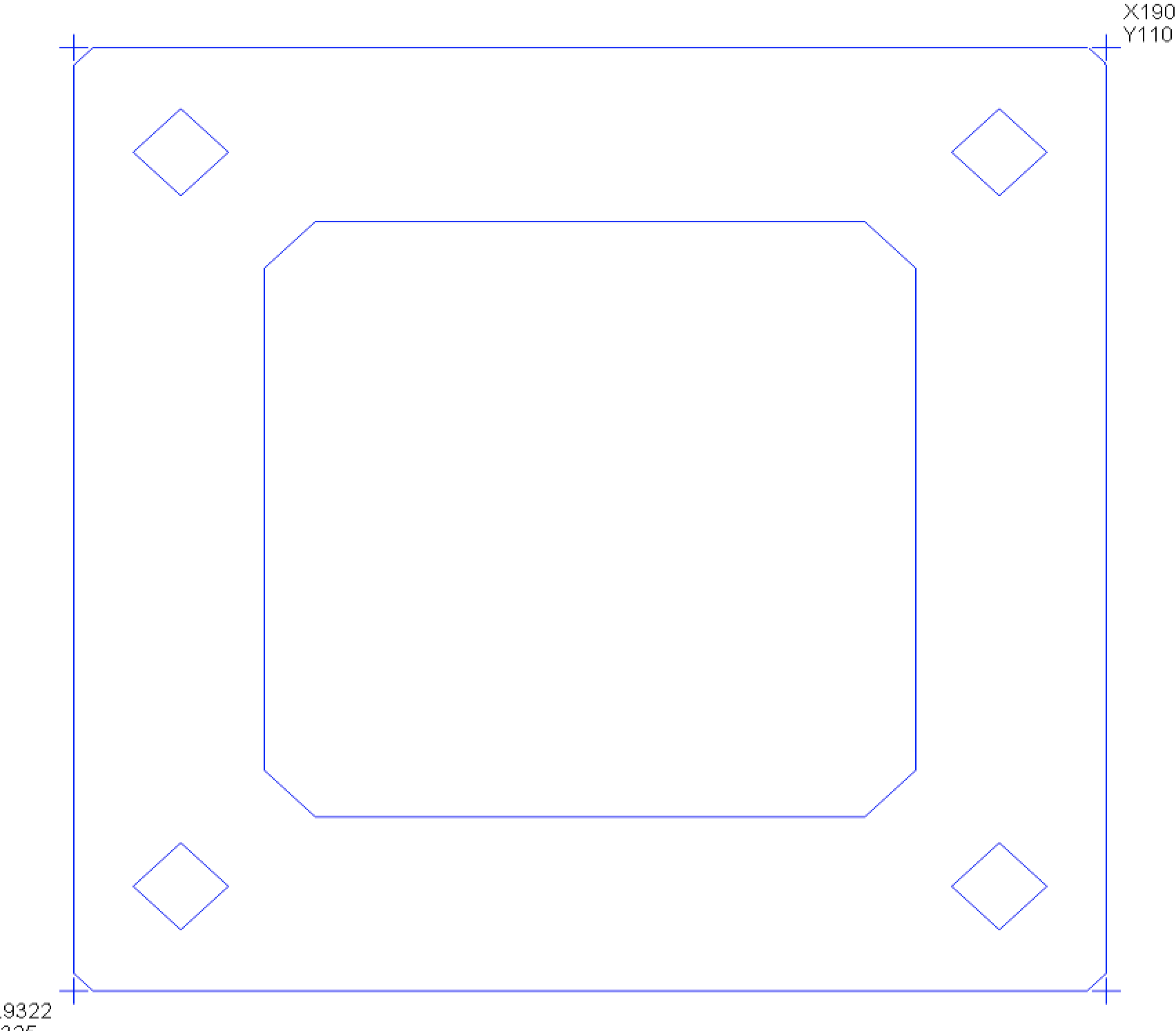

For some reason, the exported file shows the circles as squares (see below), although they're definitely circles in the imported file, and nothing is changed in the file before it's exported.
Does anyone know why this would be, please?

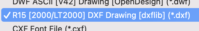

Hi,
One can export to a DXF based on dxflib: R15 [2000/LT2000] DXF Drawing [dxflib]
And also based on OpenDesign libraries: R15 [2000/LT2000] DXF Drawing [OpenDesign] or as DWG.

I suspect that all are Polylines.
Especially when the the inner and the outer contour are intended to be rounded.
Probably the bulge factors are not accounted for and what remains is the chord of the intended Arc.
Then the 'holes' may be considered as a chain of 90°Arcs but only displayed as the 4 straight chords.
That may be simply a visualization limitation when dealing with Polylines.
Are there any G2/3 moves in the generated G-Code when displaying squares?
If yes, Arc-like Polyline segments are not rendered on screen.
Otherwise they are not supported.
You could try to explode (XP) all the Polylines to Line and Arc-segments before saving to DXF.
Most likely also supported ...

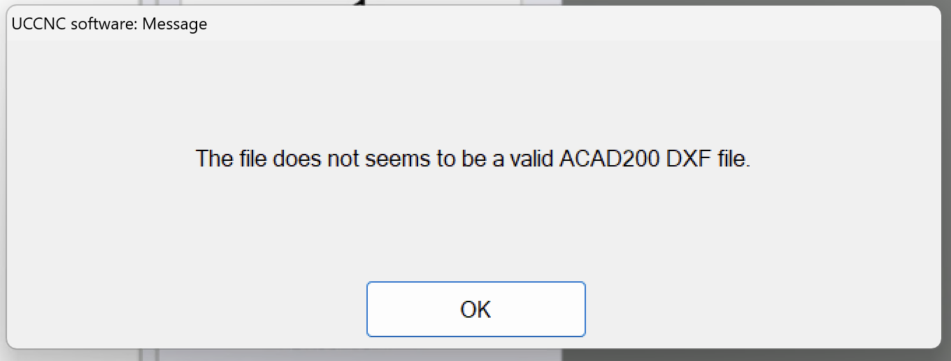

The software only supports dxf files. I tried dwg but got the following error:
Both the OpenDesign and dxflib present the tilted squares, but I understand what they are now, thank you. The outer chamfers are not rounded, by the way.
There are no G2/G3 moves. They're all G0/G1.
I'll try the exploding bit, and see how it goes.
Thank you
Update: I edited one of the circles by exploding it and that vector is now round, so this looks promising!
Further Update: So, I selected all the vectors, XP'd them and exported the file - but forgot to change it from an r@& format, and the file loaded properly and I was able to generate a toolpath, so maybe the XP is the solution!
Thank you
